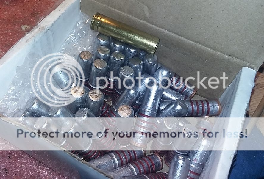

Below are the pills I am loading. About 1.7" long (.45 acp brass for scale). Cartridge overall length will matter, but seating depth is irrelevant (i.e. any brass length from 1.8" to 2.5" will work with these pills in a .458 WM or .458 Lott). Think breech seating (like the big guns by US Navy), although this is actually case seating and not breech seating).
Pills can be bought from Matt's Bullets, for around $0.50 a pill http://www.mattsbullets.com/index.php?main_page=product_info&products_id=319

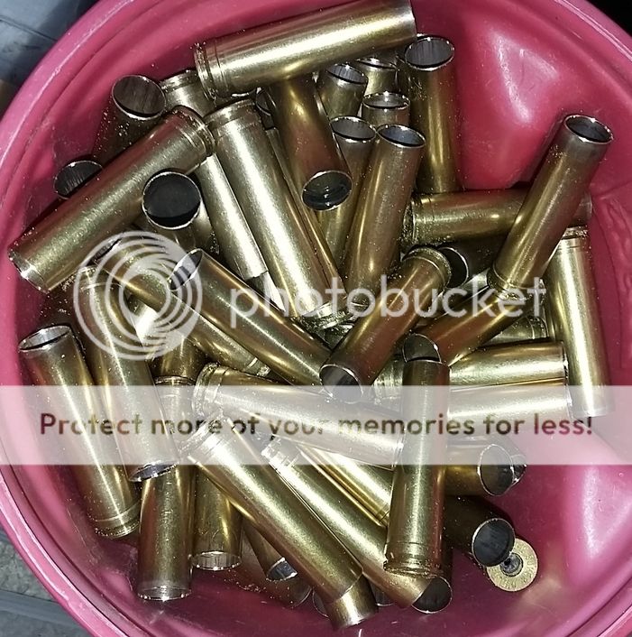

Step 2:
After picture:

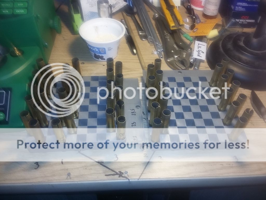

Exactly... that was the 18 or 20 grain recipe I read about on the internet. I have backed off from that quite a bit, but still having some splits... tweeking my recipe further... almost there. Edit... Please save that brass for me... I am going to try some something fun... see if we can convert that pup to run in an AR-10!!!
This is some .300 H&H that I converted to .340 Weatherby yesterday. Five on the left vs. five on the right.
FYI, I learned that because .300 H&H has a tapered chamber, debris can fall in the chamber (from the previous fire form) and when the next round is fire formed the debris will stick the case in the chamber. Easy enough to tap out with a rod, but still leaves Cream Of Wheat dimples.

Practice makes better. Tweeking the fireform load
Before and after on .300WM brass

7mm brass is being fire formed into a variant of .458WM.
Perfecting Cream of Wheat load now to mitigate splits.
Powder charge below and # of splits is as follows
6.6 and 3 splits per 10
7.7 and 1 split per 10
8.8 and 3 splits per 10
9.9 and 3 splits per 10
11 and 3 splits per 10
Cases that split will be cut down to 2.1" and used in a AR-10 in .458 that I am working on.

Brass (formerly 7mm RM) is now G2G as .458WM (for subs).

Originally Posted By: mequirky
7mm to 458 Lott may be too much.
Those became these...
.458 American (pretty much a .45-70) from an AR-10 that I am building now.
